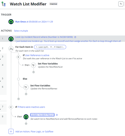

Ok, I built this out for the practice. Before we start, please be aware that Glide_List fields are simply strings that store comma separated sys_ids.  Observe.
You'll also need to define two flow variables
- NewWatchList:  this will store our valid user sys_id's to pump back into the watch list
- RemovedNames:  This will store a string of friendly user names that we removed from the watch list.  This isn't required, just going to make your Incident work notes more informative.
Here's the flow....

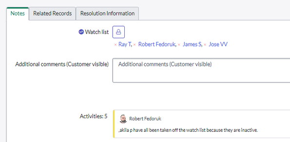

My first look up was just to a single sample Incident.  You'd want to look up a set of records then do a For Each to loop through them.  Anyway... here's what my sample incident started with.  Akila P is inactive
My first For Each is simple. Just a For Each entry in the incident's Watch List.
Since the For Each is getting a user reference each time, lets ask if that user is active.

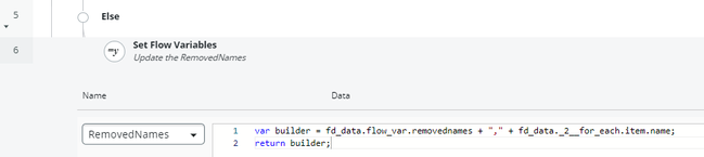

So if the user is NOT active, lets add their name to flow variable RemovedNames.  Notice this time I'm not getting the user's sys_id, I'm getting their name!

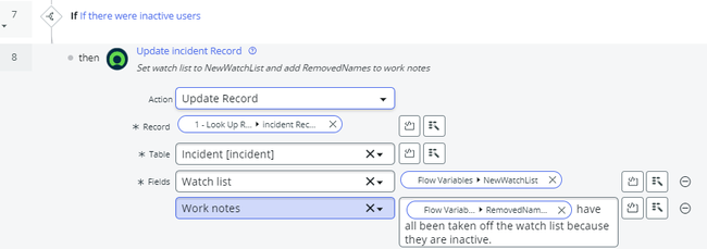

Now that we've looped through all the users in the watch list, lets update the Incident.  But we only need to update IF there were users to remove.  We'll know if the cleanse was unnecessary if RemovedNames is not empty.
Now we just update the watch list (with NewWatchList) and then add a charming little work note to inform people which users have been removed from the watch list.
BOOM!!   Cleansed watch list and informative work note if users were removed.  (forgive me I was too lazy to hyper optimize the grammar of the work note update.)
