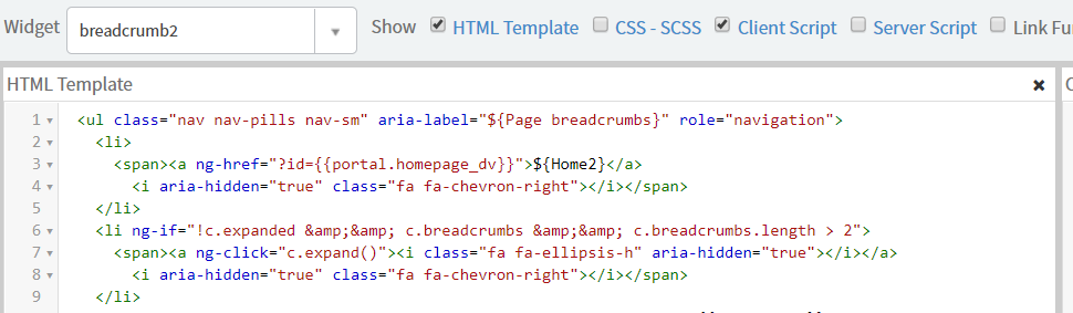

hi JV,
Just had a further digging, looking at the 'breadcrumb' widget, OOTB, its being hard coded as "Home".
I then cloned it and modify a bit and verified that its being hard coded as well.
Perhaps u can trace through from Page -> look at the widget in it and check if its the OOTB widget or a custom widget?
hope this helps.

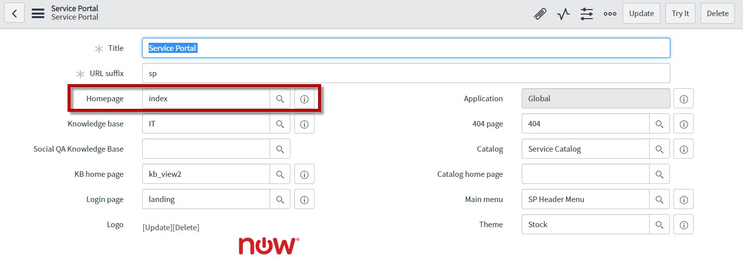

hi JV,
check your service portal 'homepage' configuration to see which site it is pointing to?
hope this helps.
I have it pointed to a new Homepage I created:
so I guess question is is there a way to rename what that link would say instead of KB Home to Home?

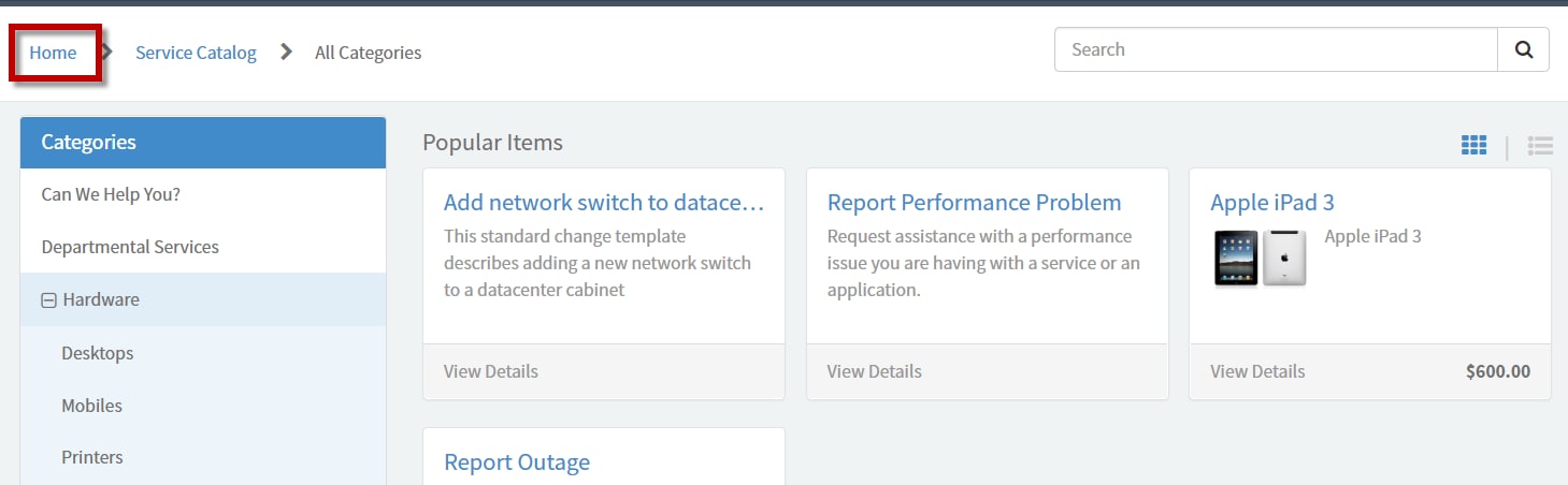

So I played around with it a little bit and the weird thing is if I have it as Home or even Home with a space afterwards it changes it to KB Home for some reason, but when I change the word entirely it seems to work fine. Odd but it's working now. Thanks for your help!
