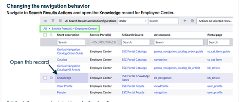

ridrepp
Hi @manishkrpal,
could you please try to check and follow this article?
Changing the navigation URL on Employee Center for ServiceNow AI Search
I remember that when we were setting up new portal, I was able to do the stuff based on that article. For correct mapping to the page we had to play around at least with the table "sp_ai_search_results_action_config" where we added our new portal into "Service Portal(s)" field for specific records. Then the article was opened on "kb_article" page and not on "form" anymore:
Hope it helps.
