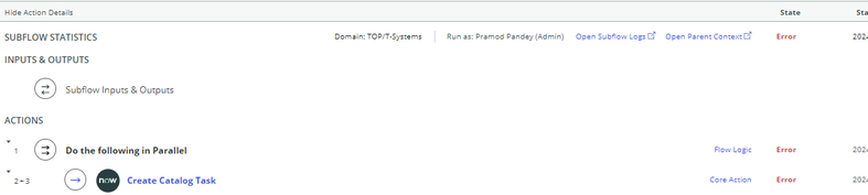

@SunilKumar_P  I created subflow for 5 parallel task as you mentioned and after activating it same i have attached it to main flow.
But when i trigger catalog item till main flow part it is working correctly as subflow logic start i am getting error,
I think error is at input output section but i am not sure.
Pramod Pandey
Hi @pramod pandey1, have you created an input in subflow? The input should be of refernce type and referencing to the sc_req_item table and then in the mainflow, you need to configure (drag & drop) requested item into the subflow input.
