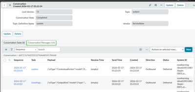

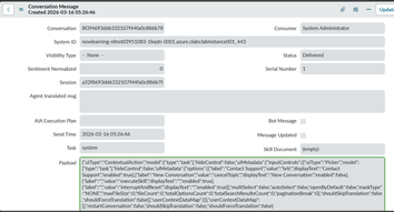

- For every interaction, it creates a record in the sys_cs_conversation table. After the chat ends, its state changes to completed.
- Every message is recorded in the sys_cs_message table in the payload field. This table is made as a related list to the above table, so we just need the conversation sys_id to get all messages.
- In the sys_cs_message table, the message is stored in a complex JSON object structure, which I have given below.

Add input as sys_cs_conversation table record. This record has basic details about the conversation like who opened it, state of chat, channel of contact, and it also has list of messages as related records.
Now we need all message records associated with this conversation record because they have the actual messages to analyze , So we use the Script Tool.

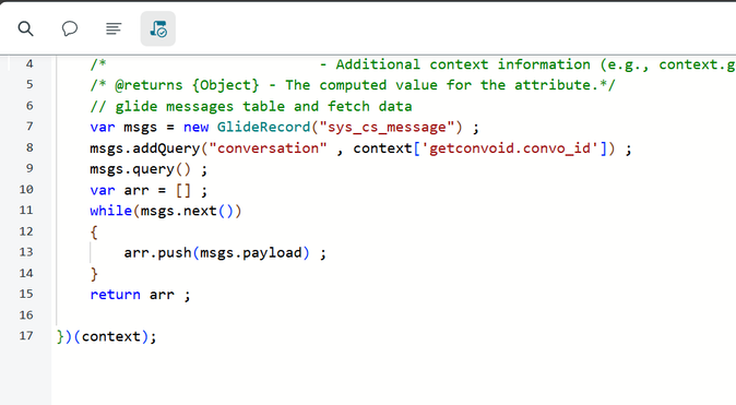

Adding SCRIPT TOOL
- In the script tool, based on the conversation record, we fetch all message records associated using GlideRecord.

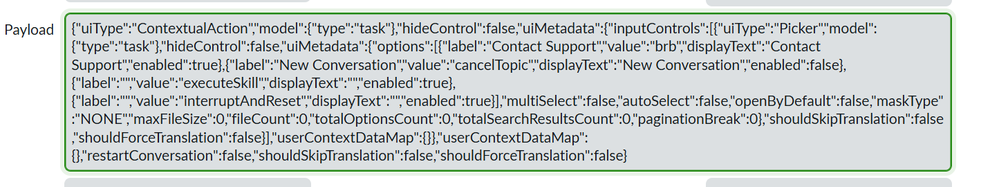

These message records have the payload field, which has a complex JSON object. In this object, we get the actual message. - The payload JSON object looks like this:
- This is the script I used. It takes all the above objects and puts them in an array. Now we have an array of payloads. These can be passed to the prompt.
- (function runScript(context) {/* @Param {Object} context - Execution context, which may include:*//* - Previous tool outputs/inputs (e.g., context['ToolName.attributeName'] or context.getValue('ToolName.attributeName')).*//* - Additional context information (e.g., context.getAllValues()).*//* @returns {Object} - The computed value for the attribute.*/// glide messages table and fetch datavar msgs = new GlideRecord("sys_cs_message") ;msgs.addQuery("conversation" , context['getconvoid.convo_id']) ;msgs.query() ;var arr = [] ;while(msgs.next()){arr.push(msgs.payload) ;}return arr ;})(context);
- We can access other tool data using:
context[toolname.attributename] in script.
Note: Here in the script, we cannot put only message text in the array, but the overall payload object. We write the prompt to analyze text from it.

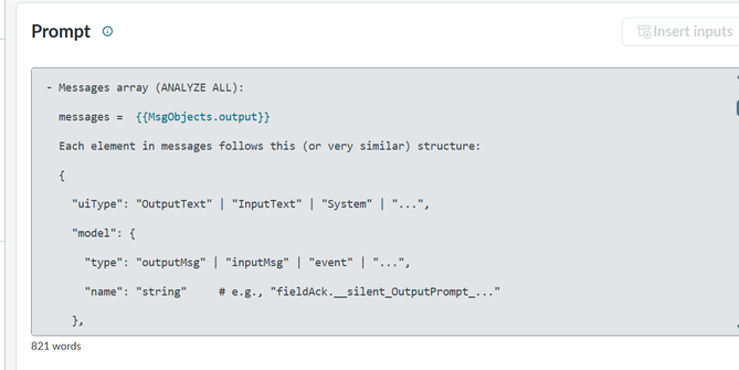

Prompt
- We define clearly the role, context, goal, and output format.
- We pass the objects array (created in script tool) to the prompt. We tell the LLM to extract only message text from objects in the array.
- To help the LLM, we give the payload structure present in array objects, so it does its work better.

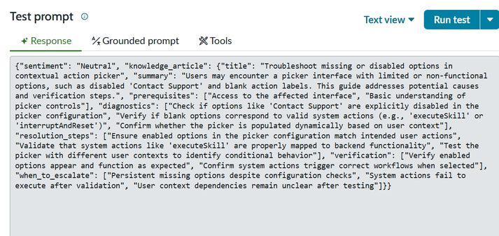

- Specify the output as a JSON object. It only has sentiment and article body.
- This output is returned to the flow, and we fetch sentiment and article text from it.
This is the main part of prompt to use :

- Messages array (ANALYZE ALL):
messages = {{MsgObjects.output}}
Each element in messages follows this (or very similar) structure:
"uiType": "OutputText" | "InputText" | "System" | "...",
"model": {
"type": "outputMsg" | "inputMsg" | "event" | "...",
"name": "string" # e.g., "fieldAck.__silent_OutputPrompt_..."
"plainTextMessage": "string", # may be present for display text
"value": "string", # often duplicates visible text; prefer this if present
"hideControl": false,
"uiMetadata": {...}, # UI-only metadata (ignore for sentiment)
"shouldSkipTranslation": false,
"shouldForceTranslation": false,
... # other fields may exist; treat as non-semantic unless clearly textual

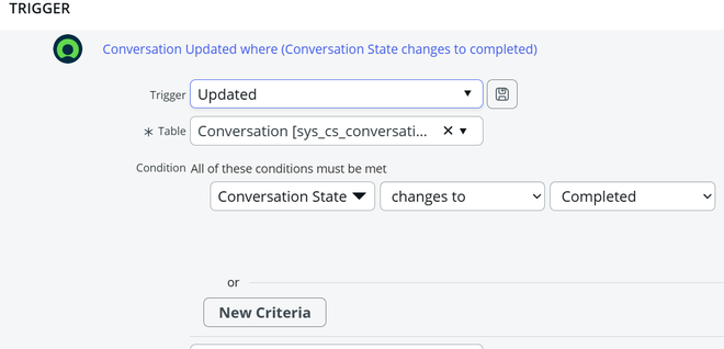

1. Trigger
- Based on the use case, when chat ends, the flow should trigger.
For this, use update record trigger and table sys_cs_conversation. - Write a condition: state changes to completed.

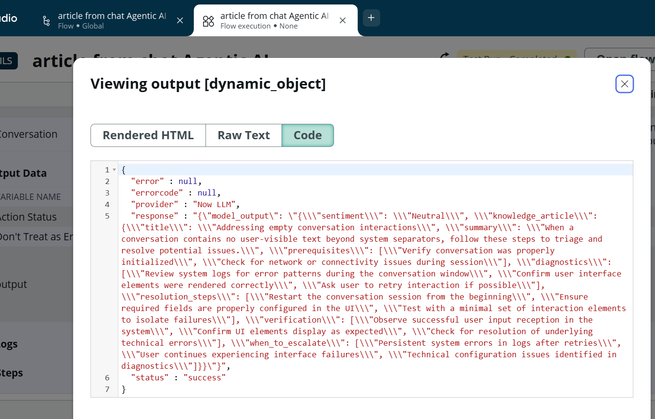

Extract Data from Skill Response
- The response we get from the skill action is a complex object and stringified. It has several layers of attributes.
- According to the output specified in the prompt, our response looks like this:
Creating Flow Variables
Extract info from skill response using script and put them in variables:
- Sentiment variable: JSON.parse(JSON.parse(fd_data._1__execute_skill.output.response).model_output).sentiment ;
- Article body variable: JSON.parse(JSON.parse(fd_data._1__execute_skill.output.response).model_output).knowledge_article ;
