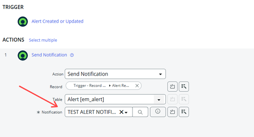

I'm trying to configure a dynamic notification process for a customer to allow them to map Alert Rules to Notifications for specific stages. In Flow Designer, there is an action for "Send Notification" that requires a GlideRecord variable for the Notification (sysevent_email_action) table. However, when I try to setup a variable for that table, it is not available as a reference variable type. Additionally, the system throws an error if I try to simply pass the sys_id of a notification to the variable.

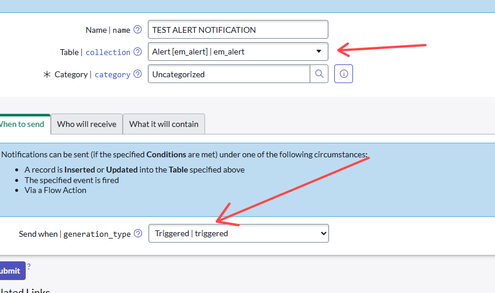

You have to create your notification first and that should be on the table you want to trigger the notification from.
Set the 'condition' of the notification to 'triggered' and once you have done that, you can both select the table and the notification in the action.

Selection from the menu isn't the problem, the issue is in dynamically specifying the notification from a flow variable or the output of a previous action.
