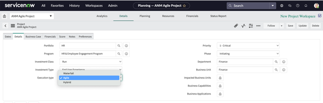

    A) Create project from the demand.
    B) Make that project execution type as Agile or Hybrid (depending the nature of the project)

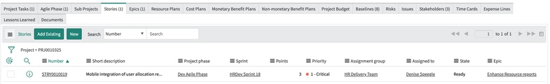

    C) Add your user stories to this project (using the Stories related list of the project)

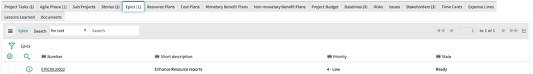

    D) On adding the user stories to the project, the epics (associated with the added user stories) will automatically start showing up in the epics related list of that project.
