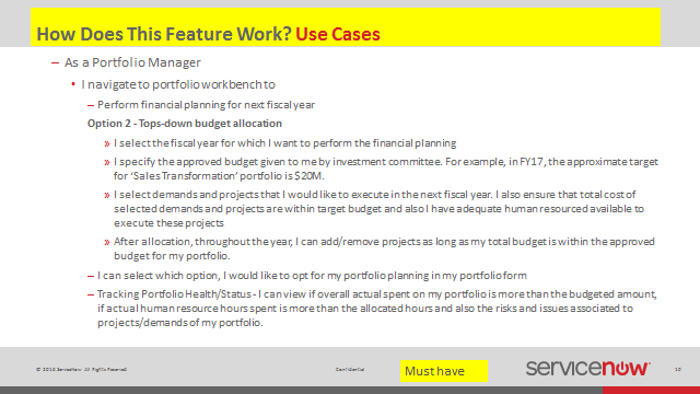

Hi sreedharkalisetty
Technical-wise, there isn't anything like an approval button for budgets. It is a matter of roles. Budget plans . Once a budget is agreed upon, you promote budgets to forecasts Budget forecasts Promote a budget plan to a forecast .
Process-wise, approval would depend on the organization. Here is a sample of roles in budgeting:
