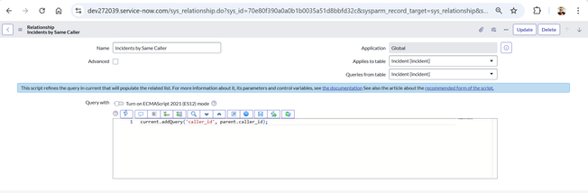

02-26-2025 05:09 AM
Hi @BiancaKerchhoff ,
I believe you have already created a relationship in the Relationship Table. Now utilize the script section to establish a relationship between the Project Action and Portfolio Record.
Refer below example:
