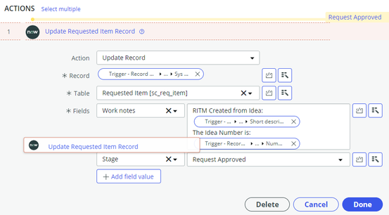

Joseph Charlie
Use Flow Designer, with a trigger that monitors for an update on the Idea table. Once the Idea is updated, update the RITM as needed. You can also add a wait condition for the RITM to update the Idea once the RITM is closed.
I am not familiar with Flow Designer, if there is anyway you can help?
I would want a wait condition for Demand number to populate on Idea form and then RITM to be created with all the Idea fields and values including the demand Number.
From Left Nav Open Flow Designer>New>provide a name.
Trigger>Updated
Table> name of the table that contains Idea
Condition> (I used Task is not empty)
Run Trigger> Once
Actions> Update Record
Record>sys_id of the task record created
Table> sc_req_item or what ever table contains your RITM
Fields> update the fields needed you can use info from the idea table to write to the description field.
Ex. Work note = Ritm Created from Idea {pill} Trigger-Record Updated>Idea Record>Short Description.
Update other fields as needed.
Add Wait For Condition {My use case was to wait till the RITM is closed}
This will cause the flow to pause until the RITM is updated.
Update Record>Trigger-Record Updated (Idea)
Table (idea table)
Fields: State = Completed
Close Notes = {pill} Update Record>Requested Item Record>Work notes
