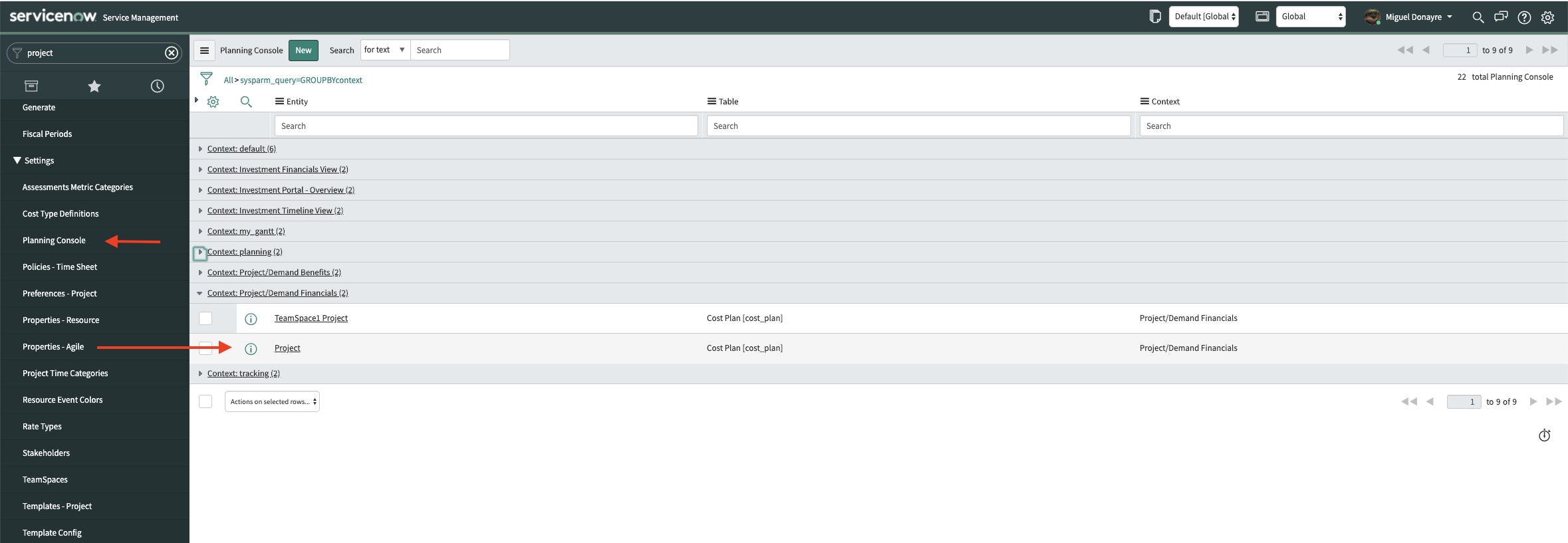

Go to Project--> Settings--> Planning Console
On the Planning Console list view go to the "Context: Project/Demand Financials"
Click on Project
On the new form that it opens up, click on the new button" Here you will need to add the new custom column you created. In the JSON field, it has to match exactly to what the column name is.  For this example, I create a custom field called Test Planned console - u_test_plannng_console. Save it.
Let's go back to the Planning console Project form(where you clicked the new button)
This is where you can hide fields and change the order it appears in the Planning console.

Miguel Donayre
Hello @avohra68,
Follow these steps -
Click on Project
