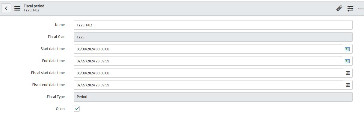

I am working on ITBM, and the table i am referring is fiscal_period. There are two fields one is the Fiscal Start Time(Date/Time field type) and the other one is the Start Date Time(Schedule Date/Time field type). So i need to compare if the cost_plan record is in the respective fiscal and for that i am comparing the date time fields. The display Value is similar to that of the Date time field type, but on the server side i get the value something like this"20240630T000000"
So my query is what is this value type, should i use this while comparing with other date time values? and i tried to convert it using the GlideDateTime but was not able to. One good thing is that if i try to get the display value of this field i get the date time in system timezone and not user based TZ.
