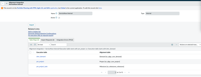

Another reason could be that integration might be missing due to teamspace. Current integration looks like following:
In your case, it should be
(Execution Table) teamspace1.pm_project -> teamspace1.sn_align_core_project (Alignment Table)
(Execution Table) teamspace1.dmn_demand -> teamspace1.sn_align_core_demand Table)
Please note that you need to create these custom tables teamspace1.sn_align_core_project and teamspace1.sn_align_core_demand extending from sn_align_core_project and sn_align_core_demand.
