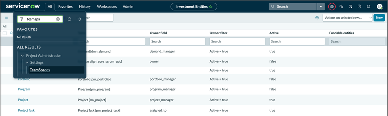

Hi @MatiasG ,
Can you please check if the entity is added to 'Investment Entities' list and set to active?
Follow below steps:
Investment Funding -> Setup -> Investment Entities
Check if the entities mentioned in the error are added and set to active. If not, using New button add them one by one and set to active.
Hope this would solve the issue.

Hi @Namita Mishra
Yes, i created the investment entities for these tables and for project workspace works fine the financials tab but for strategic planning workspace it's not working.
 Not sure what is missing.
Hi @MatiasG ,
You might have tried but still - did you try clicking the "Enable investment Entities" button?
You can raise a support case
Thank You!
Namita Mishra
Hi @Namita Mishra ,
yes i tried and it redirect me to the investment entities table where i have already created the record for the new tables (as you can see in the image above).
Yes i think that i should create a case.
