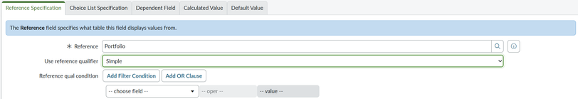

However, if you are referencing another table, you can utilize a Reference qualifier on the Dictionary entry for the "Source" field. If you are not familiar with navigating to the Dictionary entry to a field, you can right-click the field and select "Configure Dictionary".
Then, once you are in the Dictionary entry for the "Source" field, you can navigate to the "Reference Specification" tab which allows you to pick which table you want to reference. Below the Reference field [table selection], there is the "Use Reference Qualifier" drop-down. You could select "Simple" and use the Condition Builder to filter out the unwanted selections.

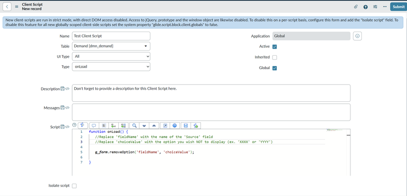

If you are NOT using a Reference field and have a String field that has a selection of Choices, you could use an onLoad Client Script that hides the choice you no longer wish to display. This would NOT impact the existing records with that particular choice(s) and would HIDE that choice for future selection. I'll include a link to the Client Script that shows examples of the GlideForm .removeOption method below.
GlideForm (g_form) | ServiceNow Developers
