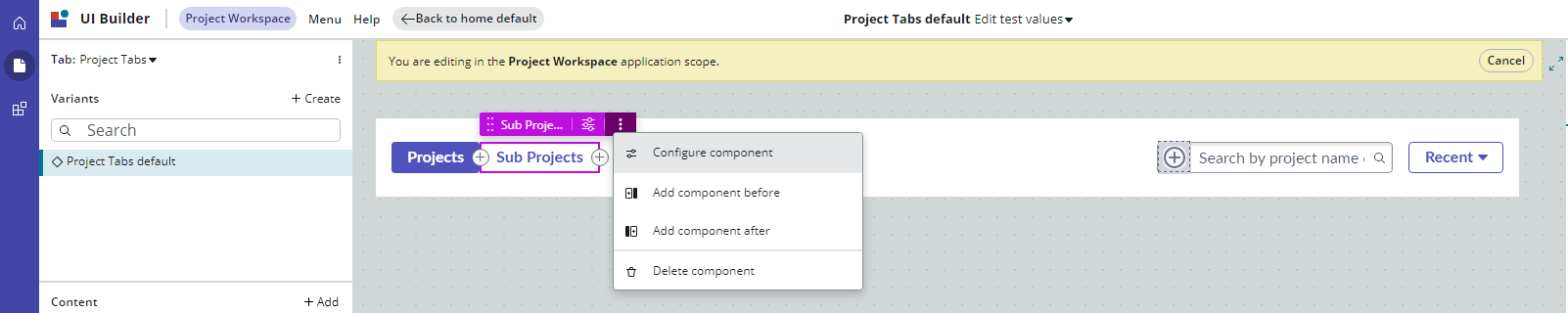

Assuming you want to remove the button that acts as a filter, in Now Experience Framework -> UI Builder, under My Experiences is the Project Workspace entry. From there, it looks like you can edit content for the body, click on the Sub Project button, click the vertical ellipses and click delete:
This removes the button altogether.
Admittedly, I went back to see if Disable was an option after testing deletion in my PDI, and it is under "Configure component", so you could just disable it on the right:

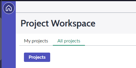

edit: So, before I submitted this, I wanted to ensure that I could still find the one Sub Project that was in the PDI demo data after this change. I'm not sure that I can, because if I go to Project -> Projects -> All and find the only one with a parent, it doesn't show up in the Project Workspace under All Projects. It looks like the "Projects" button isn't an "all projects" filter, but a "projects with no parent" filter. I really screwed up my instance, so I am going to refresh it and try again to confirm, but if it does act like this, the only way your client will be able to see projects with a parent will be in the Projects table.
The new project workspace (NPW) is based on new web platform. Please explore editing workspace in UI Builder to do any changes, such as remove the Sub Project Button from NPW.
Please note that any such changes may impact OOB functionalities.
