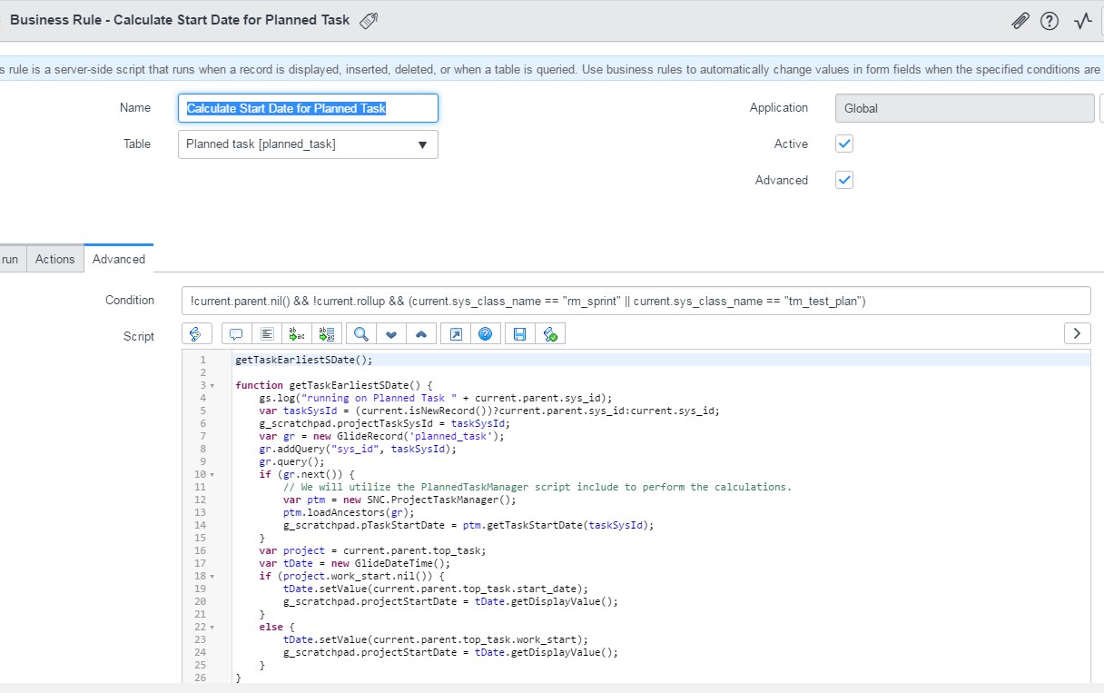

Should I turn off the BR 'Calculate Start Date for Planned Task' as well?
