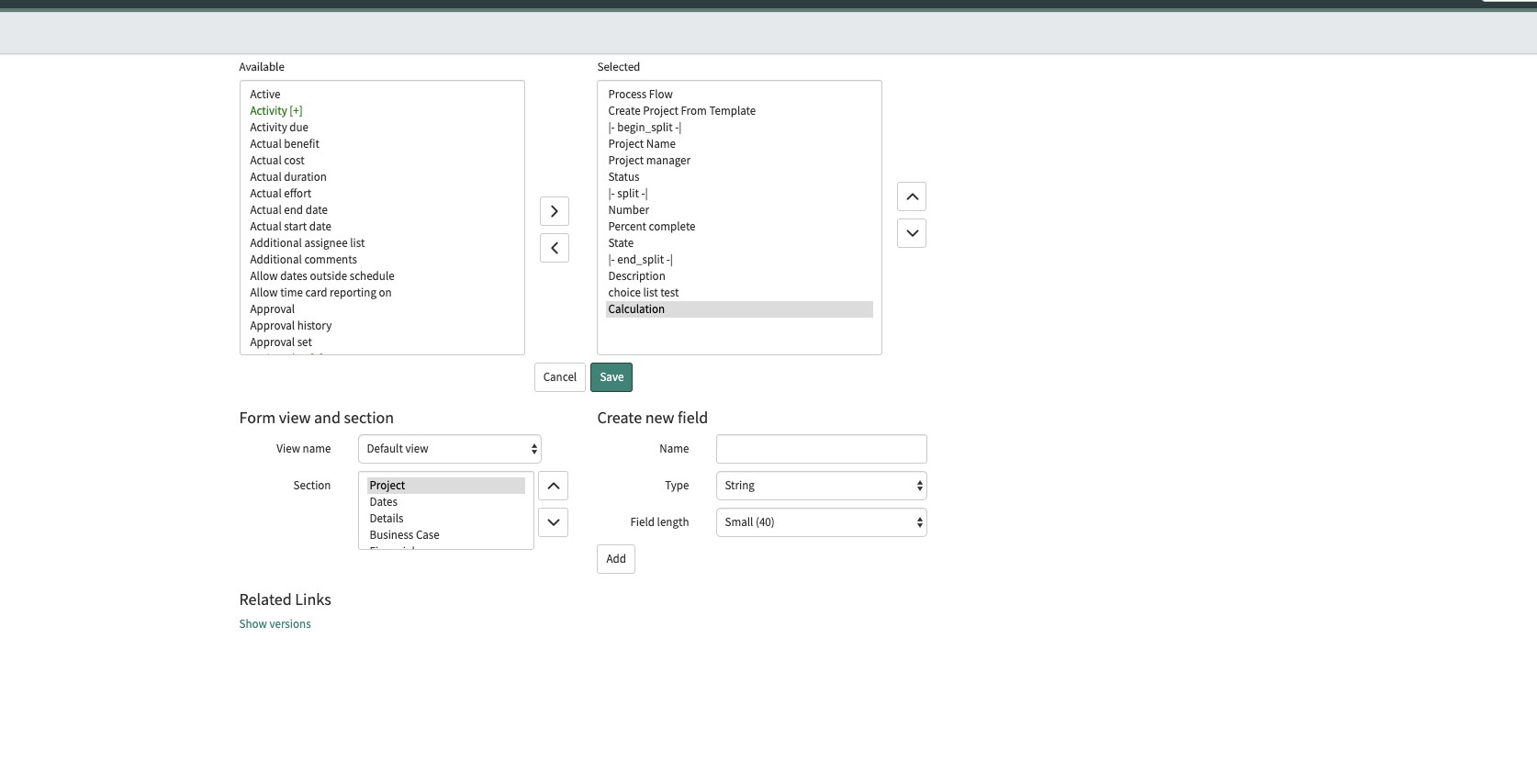

1st you will need to add the "calculation" field to the project form-
one the context menu --> configure--> form layout
look for calculation in the left list and add it to the right list using the arrows and save
you should now see it on the form. If it is set to automatic and if there are tasks associated with the project you cannot set it to manual. (It will be grayed out) The only way to change it is to delete all the associated tasks. There is no way around it.
once the task is deleted you can switch it to manual and add the task as you please. If you switch it to automatic it will set the date back to "start ASAP" and will lock it back to automatic.

There is a way to change from the project form.
