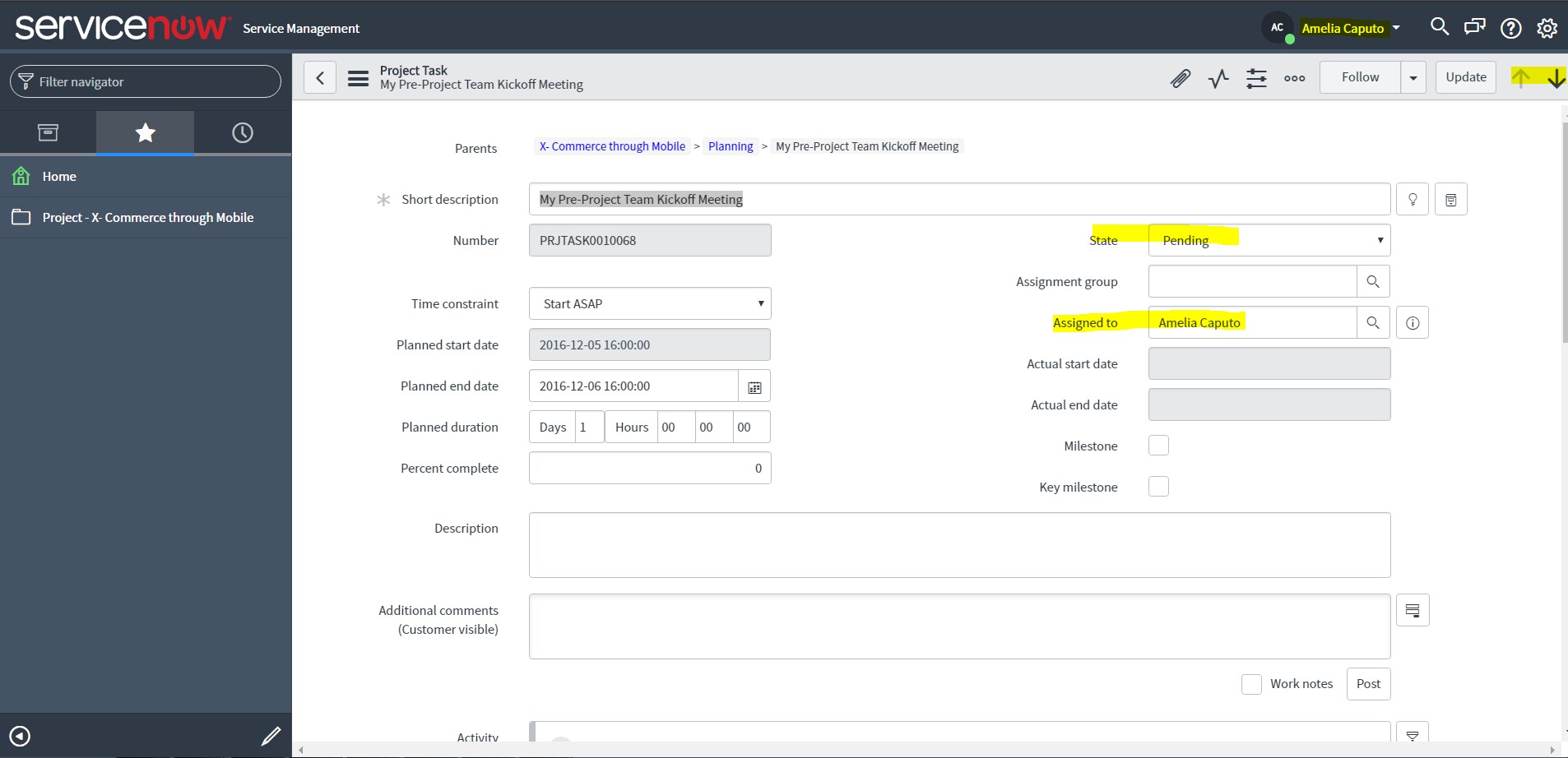

Hi Earl,
Thank you so much for your clear tips! Getting closer...
I toggled the Application picker on the SN banner, deleted my previous custom ACL, then recreated it under Global
Yet my User
still cannot delete a pending Project Task assigned to him
but then again, neither does Amelia (like in your example) who has the right permissions:
nor can the System Administrator, who has override...
...and I thought that it was going to work this time, albeit System Administrator not being able to do it all along may point to yet another higher level of permissions or a global setting, perhaps.
Scratching my head...
Guislain
And I thought I found it...
but no change even after enabling that.
