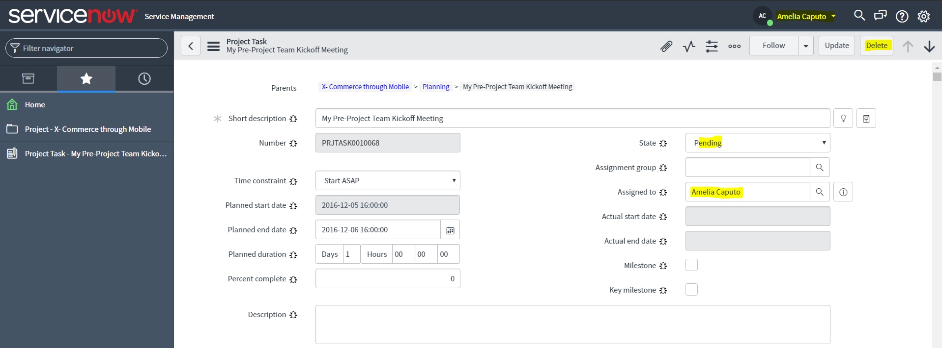

OK digging into debugger...
  1. Turned on Debug Security.
  2. Impersonate Amelia Caputo
  3. Took shortcut to PRJTASK0010068 "My Pre-Project Team Kickoff Meeting" assigned to Amelia Caputo
  4. Search "record/pm_project_task/delete" and get 1 of 9 found
    • First refers to OOTB ACL with it_manager_role which Amelia does not have; so far so good , albeit I am suspicious of the condition phrasing
    • Second refers to custom ACL with it_project_user role which Amelia does have; so far so good , albeit I am suspicious of the condition phrasing
    • But will ignore that for now, since it seems to execute the same rules from cache
    • Will ignore 1st since ACL refers to OOTB it_manager_role
    • But wonder why 2nd is now , and I am not sure how to interpret the last rule returning RC = false for CONTEXT = pm_project_task.sys_id=null
Having said so, following the UI Action breadcrumb trail, and inactivating my custom UI Action, which I described on my original post,
did solve the problem for both Amelia Caputo with the it_project_user role
        until she starts to work on her task,
and Guislain Lagron with the it_manager_role role.
Thank you both Earl & Arun; I feel a bit , but I did a lot of learning on this one!
You help was much appreciated!
Guislain
