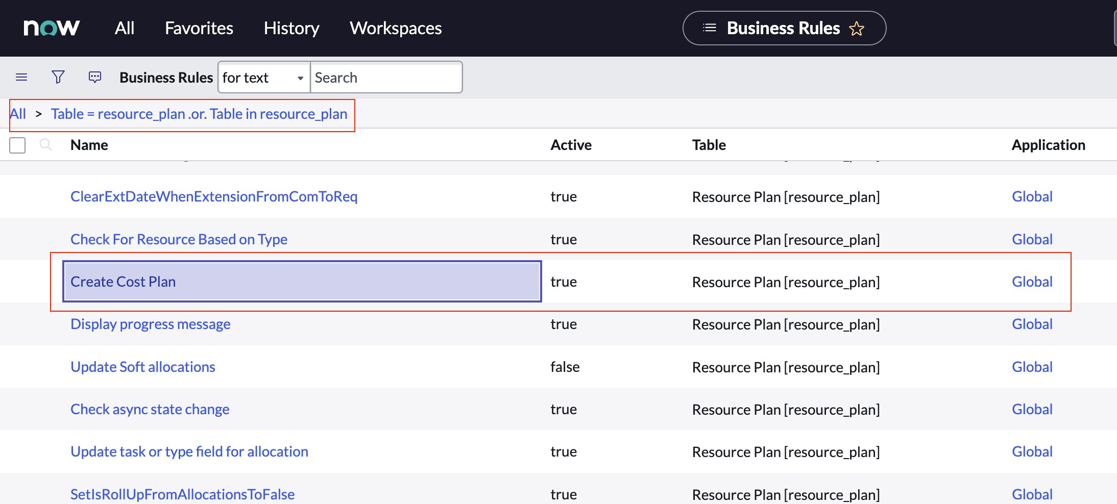

07-23-2022 02:46 AM
Tim, here you go...
Check some screenshots
Go to Resource plan right click on header and go to business rule (it will show all the business rules on that resource table as below
Open The Advance section of this business rule and you will see two script include RMCostPlanHelper and CostPlan
If you explore these two script include, you will surely get an answer on how to change default cost type.
