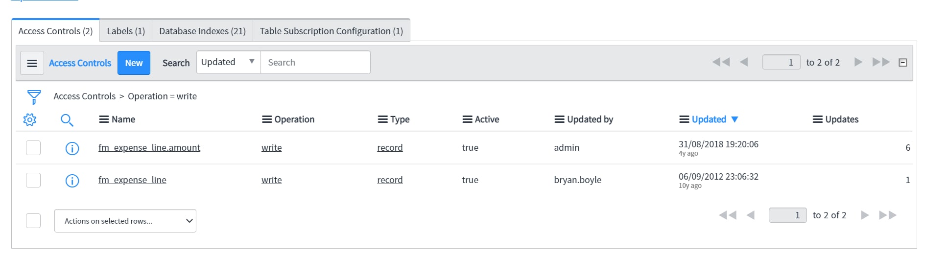

1. configure the table as below
2. filter the write ACL's as below.
3. open the 2nd ACL fm_expense_line
if you see below screen it is giving write access only to pending state. if you want you can add
state as Processed.
4. if you add state as Processed then you can write the fields.
Hope it helps!!
