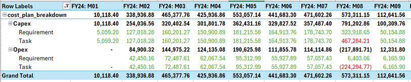

We recently migrated to SPM from PlanView Portfolios. Having an issue with Project rollup actuals not matching the total of cost plan breakdown, or expense line actuals.
Here's a visual example about what I mean:

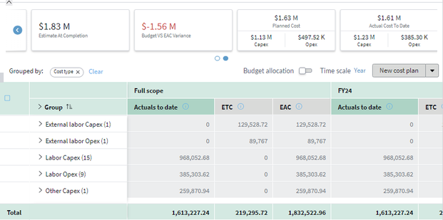

It's even more screwed up on the New Experience, as all numbers don't match. Right now, I'm trying to solve Classic first before tackling New Experience.

DavidB-ADT
Staring at that giant negative Opex number, I've just had an epiphany!
We recently realized that there's a weird gap in the Timecard Recall functionality of SPM, in that it doesn't look at either the Cost Plan or Cost Type associated with the original expense line it's reversing. So when we recalled a number of time cards to correct Rate Model gaps, the recall reversing expense lines didn't match i.e. A capex expense line was reversed with an opex expense line.
We made a flow to go and correct all those recall expense lines to match their original entry's cost type. But, my flow never 'reprocessed' the expense lines. Going to make a Flow to reprocess all recalled expense lines, and see what that does.
Edit: Reprocessing the recalled expense lines definitely helped, but I still have a capex variance. I think I'm just going to reprocess all expense lines for M07, and hopefully that'll get things back in sync.

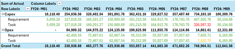

Edit 2: Reprocessed all expense line and have come to a new realization - my weird variance is on the 'Requirement' side, as my 'Task' amounts now match my expense lines:
The mystery continues...
