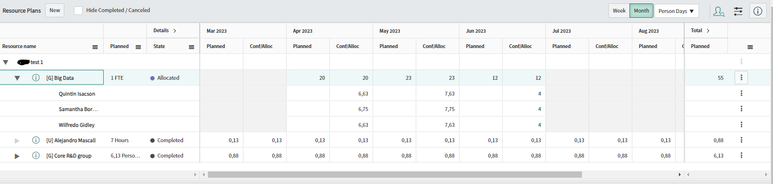

I would like to know more about the logic/reason behind the "Move Resource Plan" action on the allocation workbench. This feature is intended to shift the resource plan in time, however it has (in my opinion) a big flaw: moving a resource plan in confirmed/allocated state removes the original allocations and the system recalculates new ones.
Example: Let's have a resource plan, where a Group with "Any Members" is requested for 1 FTE (meaning 1 resource could fulfill the whole resource plan theoretically), and 3 resources allocated to this plan:
Now the resource manager moves the resource plan 1 month ahead:
Notice, that 2 out of 3 HARD allocations are removed and the system reallocated only 1 resource with full time.
This is far from ideal, as original allocation are lost and now the plan needs to be replanned from scratch.
So the question is if this "smart" redistribution can be turned off for moving the resource plans, or if not, what is a good workaround for shifting resource plans - other than cancelling and recreating them from scratch?

Attila Beregvar
Hello Marco,
Thanks for the reply! It looks like a workaround for the case, but it involves the reprocessing of allocations (instead of keeping the current ones and just shifting them in time) and even time cards, so I would avoid doing it unless absolutely necessary.
Still, the fact that using the "Move Plan" action overwrites the existing allocations made by the resource manager and replaces them with a system-calculated allocation is not a good practice. It makes this feature basically unusable if you don't want to replan your resource plans after moving them to get back your original hard allocations.
So I'm still looking for some other workaround.
