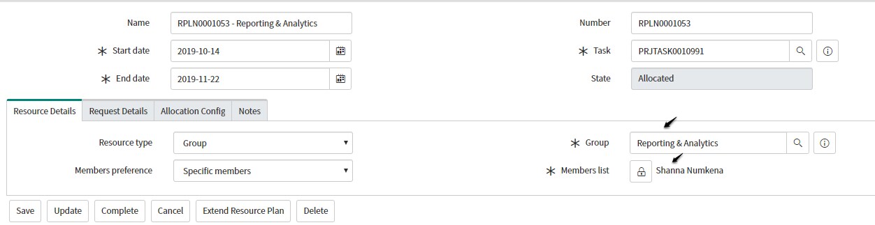

I am little confused with the Planned Cost calculation on Resource Plan on Projects.
I created a Resource Plan as shown below which is for a specific user in the Group and the group has the hourly rate of $200
Based on my understanding it multiplies Planned Hours X Group hourly rate, if my understanding is correct Planned Cost should have been $8000 -> 40 X 200, but here the total planned cost is $16000

Hi Shaik,
The rate on the group record is no longer used. The resource plan either uses a rate model if it exists and is applied to the project using the 'Rate Model' field, or will use the default value from the system property ('com.snc.time_card.default_rate'). The default value in this property is '50' which lines up with the numbers in your screen caps above.
You can still capture rates at the group level by building a rate line specifically for each group.
