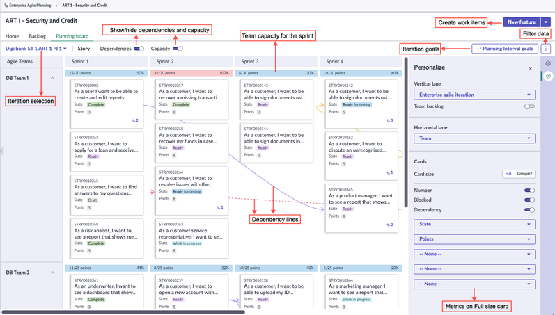

When conducting PI Planning on EAP, I would like to see the relationships between multiple features on the ART planning board.
While I can view the relationships for stories, I cannot do the same for features.

I've been having a little play with this. I can create dependencies between epics at the Capability level, and at the Agile Team level I can add Features and Capabilities to the team and to a specific script from the 'new feature' / 'new capability' options on the new button, but when I switch to the Planning Board view of the Sprint I only see the Stories. The word 'story' appears in bold as it does on your screenshot, as if it's meant to be a clickable 'drop-down' list, but no other choices are available. That page seems to be the only interface that visualises dependency lines.

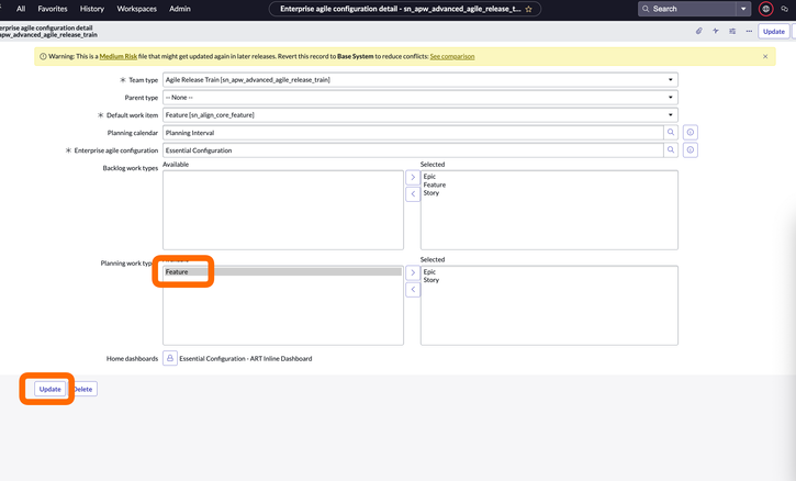

01-19-2025 04:24 PM
Thank you for your answer.
I tried those steps but I couldn't change configuration options.
As the picture below showed, I moved "Feature" to available for Planning work types.
Then clicked on "Update" but this change would not apply.
