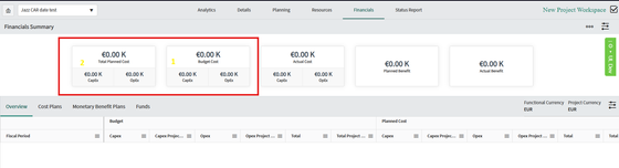

I have a requirement where I have to re-order the widgets in Financials in classic project workspace (Planning Console)
I want the Budget Cost widget as First and then Total Planned Cost, then continued with Actual cost and others.

Hi @AlfrinAJ ,
Navigate to All > Project Administration > Widgets, and try to re-order using the order field:
If this doesn't help, then try with UI builder.

I have tried changing the order, no luck!
Regarding the UI builder, I am not able to find this page collection. I found Financials Core, but that is related to Investment Portal i believe. If you can help me with UI Builder name, that would be helpful! Thanks!

 Hi @AlfrinAJ
I have worked on financial summary widget to reorder.
Navigate to Project Administration > Widgets >  Click on widget you would like to redorder > Related list > Widget associations > Order.
You will be able to reorder the financial widgets.
