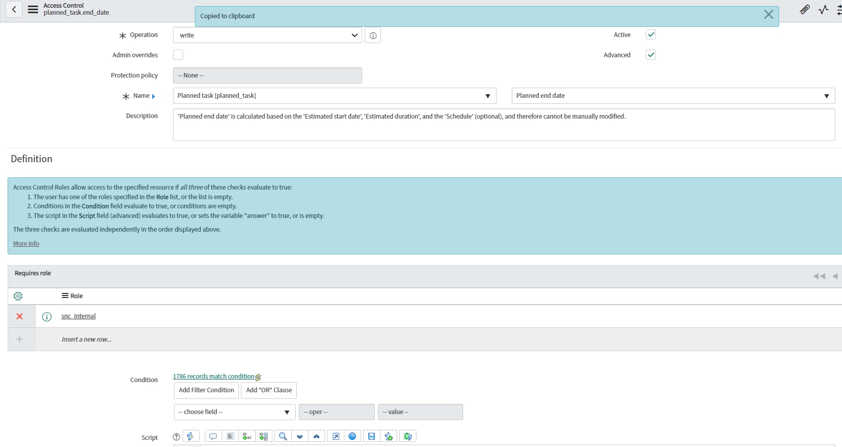

Also attaching screenshot of the ACL which shows what I have shared above:

Thanks for the response. ServiceNow support also sent me to the two ACLs which only open up the field. If I disable the ACLS the field is editable, but that does not get to the second part as to why the field isn't editable by our program managers.
My question now is about the rollup. On my instance I only see a single program related rollup (which appears to be set to rollup = 'false'). All other rollup values are false.
If there are no "true" records in the rollup table, then why is the field not editable by our program managers (per the second ACL above) which condition is "!current.rollup && current.canWrite();"? Shouldn't the program be set to rollup = "false" as there are no active rollups?
