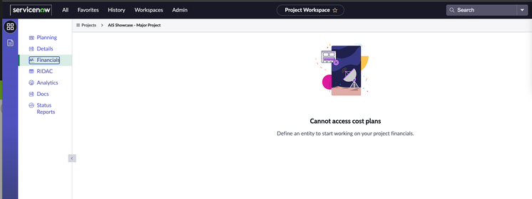

Financials Panel shows error " Cannot access cost plans .Define an entity to start working on your project financials
Even after set Investment funding entity on Project record to active, it is showing above error. Can anyone suggest in these case?

Are you getting an error as shown in below error message? If yes, then following the steps mentioned below should resolve the error:
The main reason of this error is that project \ project task is not active in the Investment Entities.
Try the following steps to resolve the error:

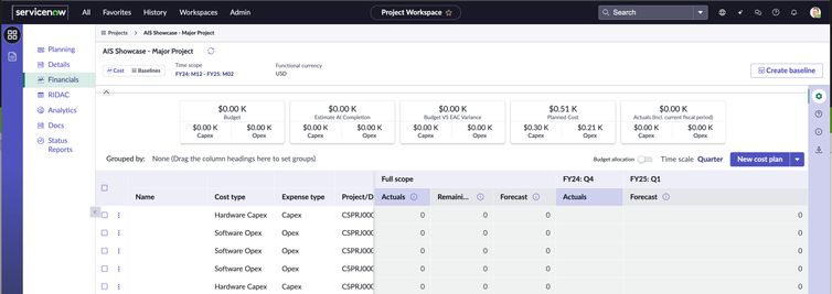

Again check the project -> financials, the error should NOT be there...
Hope this will resolve the issue; if it does please mark the response as correct to help me & community members.
