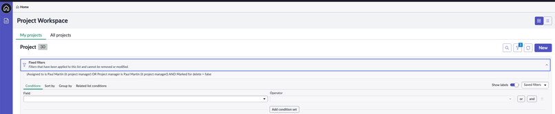

Can you help, I am wanting to update / remove the fixed filter associated with the Project workspace.  I am struggling to find out where to do this?  The older project workspace allowed users to set their own filters but the "new" Yokohama view does not appear to allow this to be updated?
Please see screen shot.
Any help would be appreciated.

OOTB the fixed filter just ensures that you see the project where logged in user is the project manager and project is NOT marked for deletion (refer below screenshot).
However you can add your own filter condition in conjunction to the fixed filter.
Looking into the fixed filter, I believe you don't want to remove it because fixed filter is just to ensure logged in user gets only his \ her projects and should NOT get the projects which are marked for deletion.

If your still finding the solution for this then check out this Change fixed filters for "My Projects" and "All Projects" tabs in Project Workspace - Support and Tr...
To update/remove the fixed filters you needs to customize the 'Get Project Tabs' data broker script logic.
