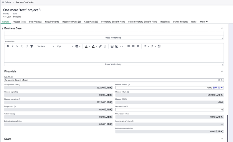

The rate model itself sounds fine in terms of configuration. Have you made the Rate Model the "Default" one (checkbox on the rate model form)? If so, keep in mind that demands/projects you've already created before the new model are not switching automatically to the new model. On the demand/project form, check under the Financials form section for the "Rate Model" field and update it accordingly:

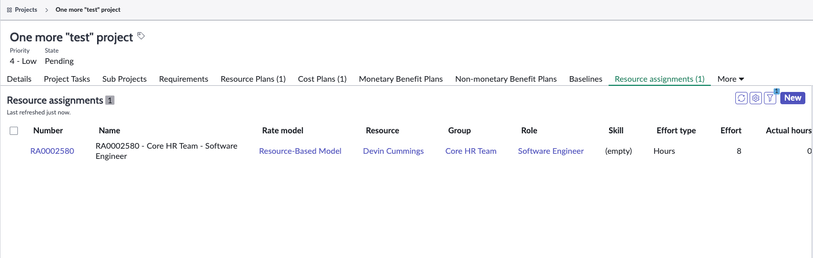

If you're working with pre-existing resource assignments, check to see whether their "Rate Model" field is pointing to a previous rate model. If it does, update the model to point to your new one or make it blank (so it will follow the project's rate model then):
If this is an operational resource assignment, the rate model field will show up on the form and you should have it pointing to your new model if that hasn't been the default one:
