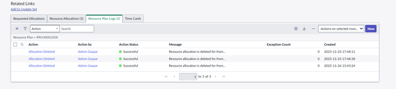

At the moment a Resource Assignment is assigned to a Resource, it is deleted, and a new one is created within the same Resource Plan. I think this is expected to happen because on the resource plan form we can see the logs like this:

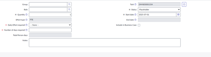

I am now having a problem; I have some custom fields on the Resource Assignment form and when the new one is created, is not getting the field values from the original RA.
