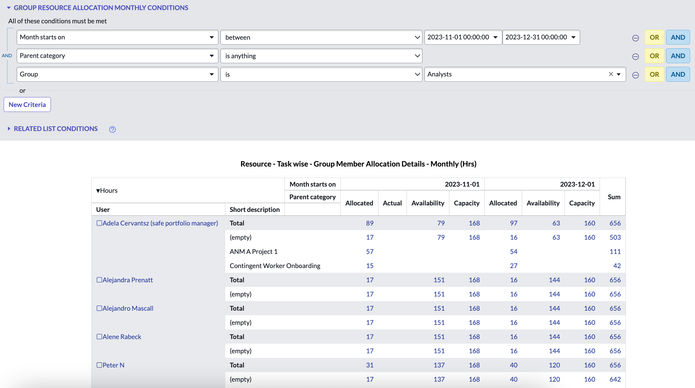

In above screenshot, the row with (empty) entry denotes the effort allocated via operational resource plans.
Basically this report considers the resource plans for populating the information.
Now, in case, someone is using the resource plans at non-project task entities such as incident then that will be captured in the report. By the way, I have not seen folks creating resource plan for such non-project entities. Sharing this point just for example and to show that report captures data from the resource plan.

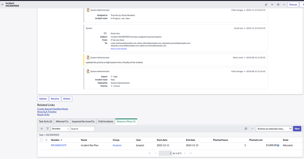

For example: Adela is allocated for 5 hours for an incident, screenshot below:

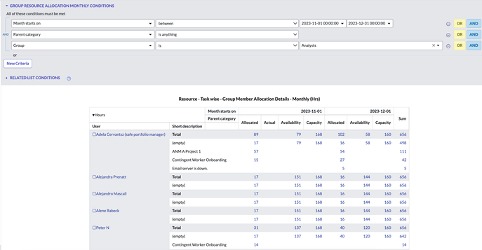

Now in the above report, entry for this incident will also be shown. Screenshot below:
