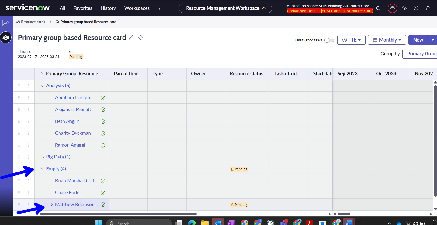

I have a question about the "Group By" filter in the Resource Management Workspace. When I select the group by filters for Primary Role, Primary Skill, or Parent Item, the chart displays "Empty" at the top. When I expand the section, the correct items do appear underneath. I'm trying to understand why "Empty" is shown at the top for these filters and what steps I can take to resolve this issue.

Hi @Eva2525,
For Resources to be grouped by Primary group on RMW, the employee profile should have a primary group selected on the Employee profiles table.
If primary group is not selected, then they categorize under Empty on RMW. Please see the attached screenshots for more details.
