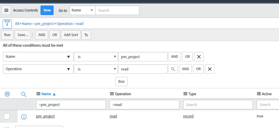

4.   Then to go your ACLs:   System Security >> ACLs >> search name for "pm_project"
5.   Add this into the script, do NOT update role conditions, this needs to be evaluated seprately.
"gs.hasRole("yourRoleName");//make sure you change this to the exact name of your role
This will limit record acess like you want in a simple way.
