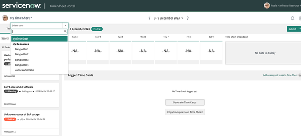

The objective of filling the timesheet of a user by another can be achieved however not exactly as it is mentioned above. Time sheet of a user can also be filled by his/her manager. As shown in below timesheet, the manager persona, gets a drop down with the value as "My resources" - using this option the timesheet of the team members can be filled by manager.

Hi @Namita Mishra
I appreciate your prompt response and thank you for your initial insights.
To provide further clarification, my current project involves enabling users with the 'timecard_user' role to delegate and fill timesheets on behalf of other users possessing the same 'timecard_user' role. The objective is to implement a delegate option specifically tailored for users with this role.
If you have any firsthand experience or additional insights into implementing such a feature, or if you can share any code snippets and best practices, it would be extremely helpful for the ongoing development.
Thank you once again for your support and expertise!
Hi @KapilVishwaka ,
Thanks for sharing the use case.
As a governance best practice, one user should not be filling the timesheet of another user (peer) that is why we have not provided this feature as out of the box.
I would recommend to check if the team lead ( for his / her team) can fill the timesheet.
Regarding the point can it be done - I believe customization is possible but again i suggest to not use customization and check with the business users if they would agree to use out of the box functionality.
Thank You!
Namita Mishra
has there been any changes to this?
We are looking for a similar solution where user to user delegation should work and the MAIN reason is because they are very senior folks and they delegate the timesheet to their executive assistants.
