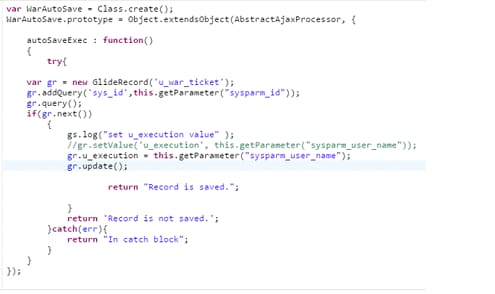

I am calling save function at a set interval. I am setting the focus to an HTML field on my form but the cursor stands at the beginning of the text in HTML field each time the form loads. How can I write a script that puts the cursor at the end of the text in that field?

I used this code already but it didnt work. It works for the regular string fields but the HTML field on my form auto-saves every 5 mins. Whenever it is autosaved, the carat jumps to the previous line. Meaning, if a user is typing something in line 10, the cursor jumps to line 9 after autosave is called. I am trying to fix this by setting the cursor position to the end of the text after autosaving HTML field. Here is the screenshot of code I am using,
Here is the script include :

I have to defer to smarter client scripting minds than mine. Often things like this get down to browser compatibility which is why we always encourage people to use the ServiceNow API whenever possible. In this case, it doesn't appear that you can. Hopefully someone with better client side scripting skills than I can help (and provide a browser independent solution that limits upgrade issues.)
