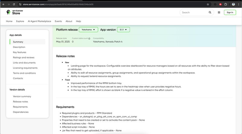

Hi all,
Resource Management Workspace just needs PPM standard?
Our client has SPM pro, so it should be included right?
Differently, what is needed to have it?
Many thanks,
Tommaso

Check all the plugins. Resource mgt is included in SPM standard and SPM pro (last time I checked). You just need to make sure you activate all the plugins you need.

If you have the Pro License then no additional Cost.

Hi @Tommaso2 ,
You do not have to pay additional cost for Resource Management Workspace. It is included in SPM Pro without any additional cost/license.
To enable, it is necessary to install the ' Resource Management Workspace' plugin in current release.
06-03-2025 10:22 PM
FYI - Plan is that in future release, it will be automatically installed with SPM plugin... However, this is for post Yokohama so confirmation would be near to Zurich release....

To activate Resource Management Workspace, you need to install the 'Resource Management Workspace' application from the ServiceNow Store.
Name: Resource Management Workspace

Thank you, two questions:
- Resource Management Workspace is included in SPM Pro without any additional cost/license?
- So to install it is necessary ServiceNow Store or the plugins?
Thank you!
Tommaso
06-03-2025 10:19 PM
Hi @Tommaso2 ,
06-03-2025 10:22 PM
