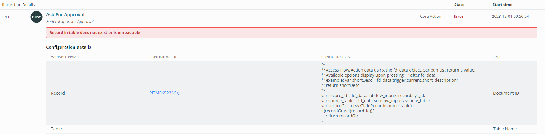

I created a approval sub flow in Flow Designer, that I am trying to make dynamic so that it can be used on multiple tables including custom tables not extending task. The issue I am seeing is that the 'Ask For Approval' action will not fill in the table when using a Document ID record. When running a test, I receive an error saying the "Record in table does not exist or is unreadable". I have a source table field that can be used for the table but it is greyed out. Does anyone know if it is possible to script the table name or populate it somehow when the table is not known in the 'Ask for Approval' action?

Thanks for your reply! Yeah I tried that as well. The data pill for the Look Up Record is greyed out and cannot be added. So I tried scripting it to get that looked up record and it found it during runtime but still receive the error that table name does not exist or is unreadable.

Thanks for your reply! Yeah I tried that as well. The Record data pill for the Look Up Record is greyed out when attempting to add it to the Ask for Approval. So I tried scripting it to get the looked up record and it found it during runtime but I still receive the error that table name does not exist or is unreadable. See attached screenshots.
