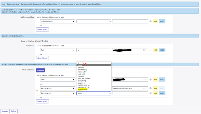

My problem is that the data condition builder doesn't let me do an "is not" for dynamic values...it only lets me use "is" for dynamic evaluation.

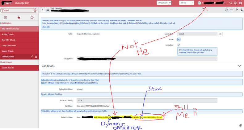

This is what I see when I look at the data condition on the filtration record in question (see screenshots below) and if I elevate to security_admin, I get the standard condition builder -- and this is what I cannot use to do the "is not (dynamic)" operator.
I know they are using a dynamic operator for this as I have tested it by trying to add it myself, but then impersonated a different admin and see that it is not dynamic, but static...which is as I would expect, based on how it was created using the condition builder.
Existing filter written by partner using dynamic "is not" (read only record before elevation):

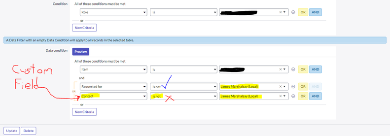

Existing filter when I try to edit after elevating as "serucity_admin" using the condition builder - see that there is no "is not (dynamic)" option available:

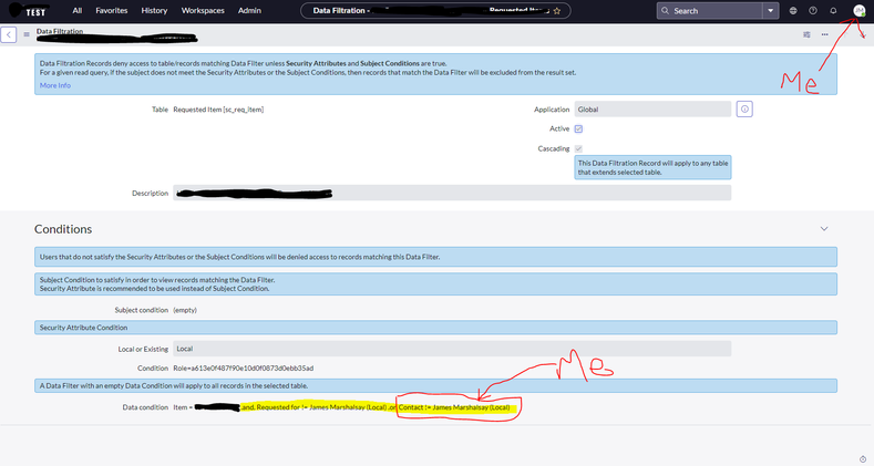

If I use the regular "is not" operator (with the red X in the screenshot above):

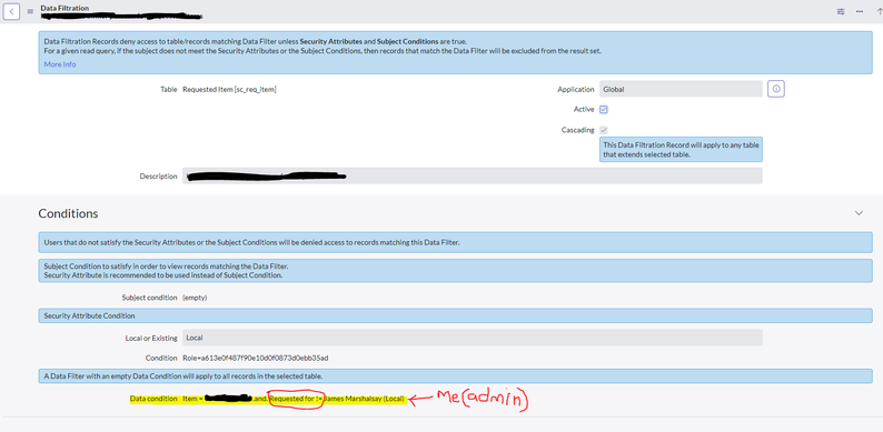

It looks fine at first...but not when I impersonate a different admin user:
Also, FYI - the reason I am impersonating an admin user, is because they have access to data filtration records. Since I can see the outcome from using the dynamic or static operator for data condition in the filtration record, I have not tested beyond this to "know" if it "actually doesn't work" (as I expect it doesn't).
Does anyone know how to use the dynamic "is not" operator in the condition builder...or some other way to write the condition and apply it to the data filtration record's data condition field?
