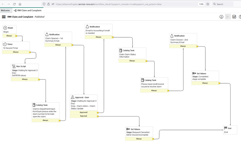

I'm trying to move an existing claim workflow into ServiceNow.    In our old system a user starts the request and the entire form is visible.   Steps to be completed later in the workflow are not writable but can be seen.   Once the writable fields are completed the form is submitted for a data entry step by the claims department.   After that the claim goes to a manager for initial approval.  Once that approval is received another data entry task is assigned.  Once that step is complete there is one more data entry step before the claim and workflow are completed.
I've recreated the form as a service catalog item and also created a workflow.  In that workflow there are tasks assigned for the data entry steps required later in the workflow.  I'm able to add the data entry variables to the tasks where needed and everything seems like it should work.    I assigned the new workflow to the new service catalog item for testing.  In the initial test all fields on the form were writable including the required data entry steps that can't be performed until later in the workflow.    This meant I couldn't submit the form.    What's the normal practice for a process like this?    Being able to define the variable data entry on a task seems the correct way to do it but I appear to be missing something that more closely ties the item and workflow to work together.

As for the approach itself, you are correct, you should split the actual job into tasks, where you show only the variables that are supposed to be filled by the fulfiller of this task.
Then, using Catalog UI Policies you can control the behavior of the fields (Mandatory, Visible, Read-Only, etc.).
I suppose in your particular use case (unless you specify what type of form do you mean, where all the fields are writable) you just need to create a Catalog UI policy which will control what fields to show to the request submitter.

We went live in June and had an outside vendor built out our initial processes.  They used workflow editor which the more I read seems like we got a bum deal.   I took an existing workflow that followed a similar path to what this one required and modified a copy.   Would you recommend I redo the workflow in designer?
I'm in the catalog UI policy now and this is what I was looking for.  Thanks for your help.
