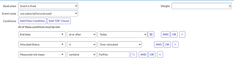

I just configured Subscription Management for my organization and I now want the Service Desk Manager to receive a notification when Fulfiller licenses are over-allocated (which they currently are).
There's an OOTB notification called "Subscription Overused" which seems exactly what I need but for some reason it's not triggering. Here's the information I have under "When to Send"
The OOTB condition is End dat at or after Today. I added the Allocated Status and Measured Role Types conditions. What am I doing wrong?
Many thanks!

Did you ever found out ? i have the same problem, even is not firing after "licencing engine" calculate an over-allocated subscription

I have done the following :
1) Create a Business Rule on subscription_detail table to execute a script firing the event :
gs.eventQueue("snc.subscription.overused", current, gs.getUserID(), "NAME OF YOU SUB");
})(current, previous);
2) designing a notification on table license_details sent when event "snc" is fired
It's working but not great yet
