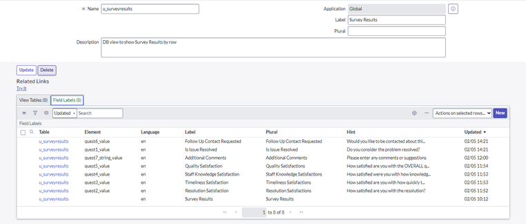

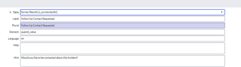

I have been working on the ability to report on our survey results in a more reader friendly format. I have created a database view to show all of the survey results in a single row and I have customized the column headers to reflect the questions instead of just "value" or "string value". However, I cannot figure out how to get the display names of the answers to show instead of the numerical value.

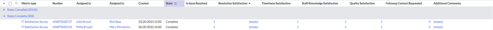

Example: In the screenshot below, the column labeled "Follow Up Contact Requested" displays a value of 0 or 1. In reality the answer to the question is Yes/No.

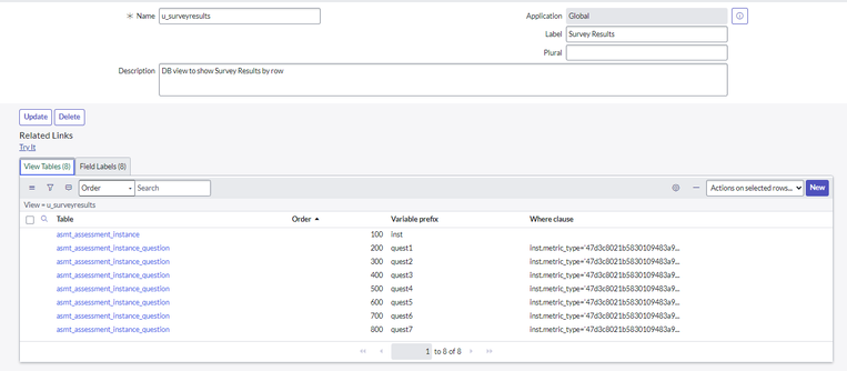

Share the DB view configuration details. Which other table you mapped in DB view along with "asmt_assessment_instance".

Hi @AshishKM,
Is this what you looking for? The other table I'm mapped to is 'asmt_assessment_instance_question'.
Thanks for sharing, checked both the table data for completed survey and found that survey response value are saved in numeric only however the Survey Questions are String or Yes/No type. Due to this numeric value, we are calculating the average CSAT score.
