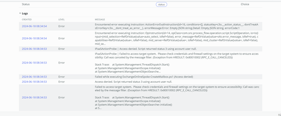

Hello Ankur, @Ankur Bawiskar
One catalog item was created in order to automate the process of creating new shared mailboxes in Azure AD from ServiceNow by using spokes.
I am using the create mailbox action from Microsoft Exchange Online spoke in flow. During testing, I receive an above error
Some more errors
ErrorEncountered error executing instruction: ActionErrorEvalInstruction{id=16, conditions=[], statusKey=c3o.__action_status__, dontTreatAsErrorKey=c3o.__dont_treat_as_error__}, errorMessage:Error: Empty JSON string,Detail: Empty JSON string, errorCode:1
ErrorIPaaSActionProbe | Access denied. Script returned status 3 using account user null.
ErrorIPaaSActionProbe | Failed to access target system. Please check credentials and firewall settings on the target system to ensure accessibility: Call was canceled by the message filter. (Exception from HRESULT: 0x80010002
Failed while executing ExchangeOnlineSpoke-CreateMailbox.ps1
I appreciate any insights on this.
poojasubhas
Hello @Ankur Bawiskar
I am using the create mailbox action from Microsoft Exchange Online spoke in flow. During testing, I receive an above error: Error: Empty JSON string, Detail: Empty JSON string.
Failed to access target system. Please check credentials and firewall settings on the target system to ensure accessibility: Call was canceled by the message filter. (Exception from HRESULT: 0x80010002 (RPC_E_CALL_CANCELED))

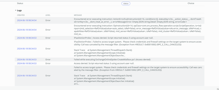

poojasubhas
Hello @Ankur Bawiskar ,
I am Facing the same issue while testing the flow.
One catalog item was created in order to automate the process of creating new shared mailboxes in Azure AD from serviceNow by using spokes.
