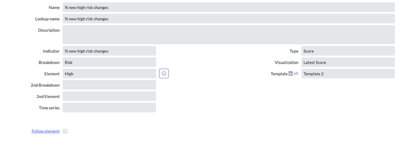

If a performance analytics widget should follow a breakdown, then you need to go to the widget configuration and check mark the "follow element".

@AndersBGS
Thanks for taking the time to answer. I don't have the "Option" or the "Settings" button to edit the "Widget" I cannot a way to get to the "Edit Widget" like the one in the screenshot you posted. Any ideas?
