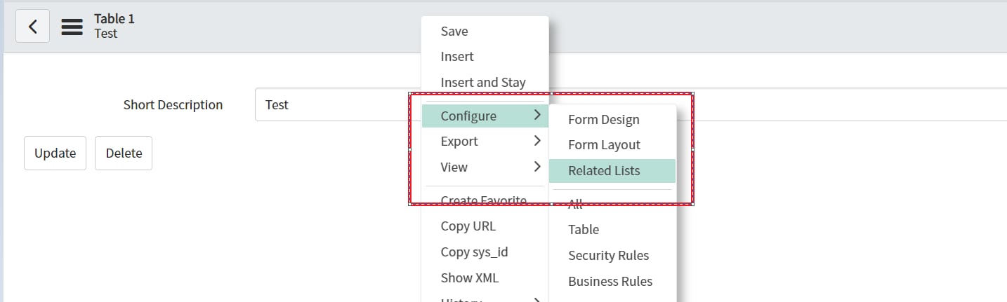

Select the Table Names as shown above and now Navigate to your Table 1 Form and then Right click on the header of the form and select Configure--> Related List as shown below:
Now select the Relationship which we have created in above steps as shown below and click on Save button:
