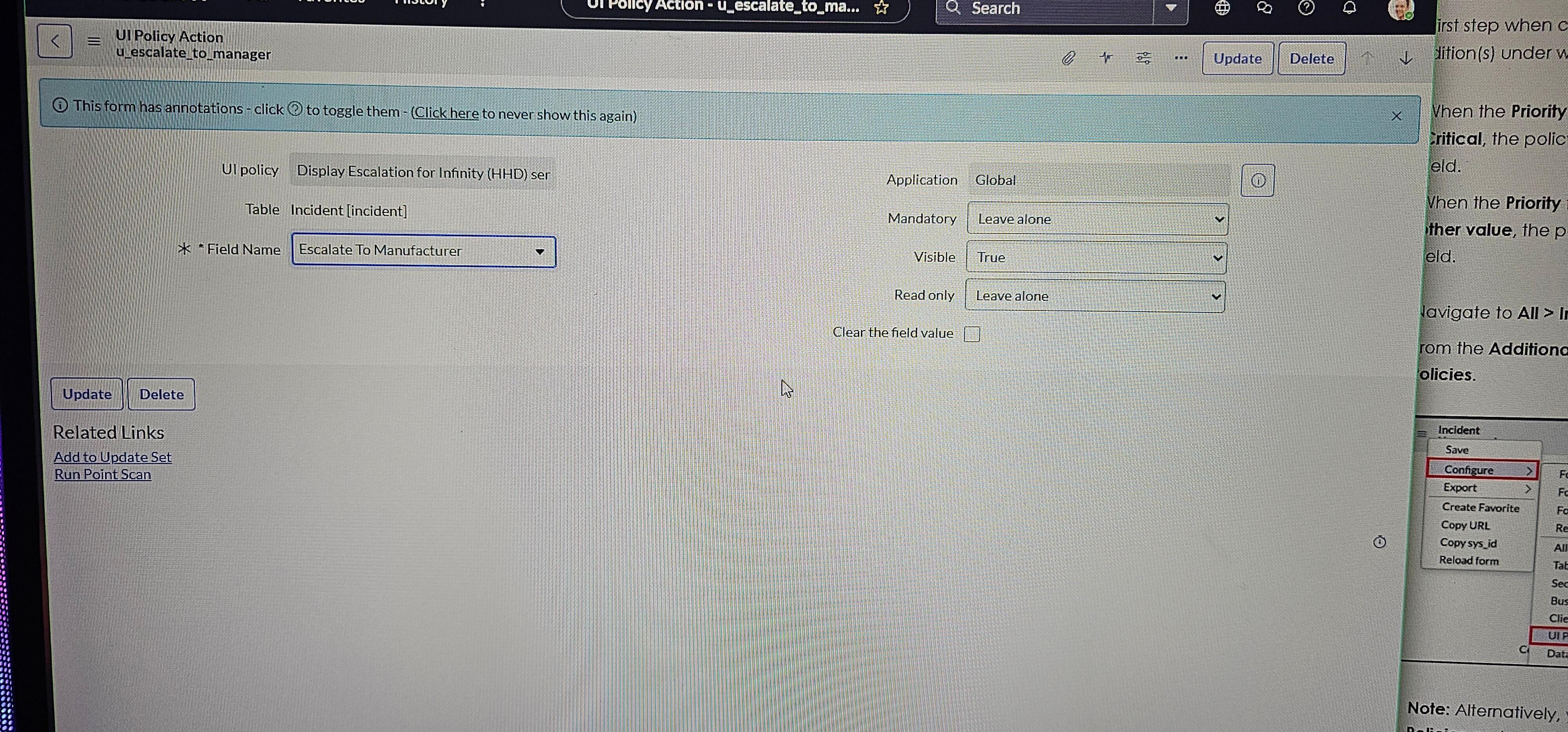

08-14-2025 09:16 PM
I also struggled with this part. Earlier in the training there's a portion where you need to create "Escalate to manufacturer" I've attached photos. Once you create it it'll show up on your tree. The other one you need is nested within the already existing options in the tree, you need to expand them. It will be under configuration item, then manufacturer and finally the one that says contact.
10-08-2025 11:09 AM
don't select Configure ==> List Layout but open any record, then select Configure==> Form Builder
create the fields by using the:
then, drag them to the forms as instructed in the lab
hope this helps.
