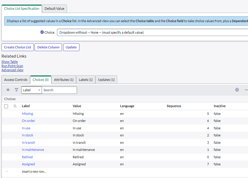

I'd appreciate to help here. Receiving the error Did you configure eight choice values on the HHD Table's State field? in the lab.
I have created all of the choices in the studio and in the dictionary entry state to match the requirments in STRY010101; however, the validation error persits no matter what order the choices are arranged. See screenshots of each screen attached. The screeshot in the lab does seem to match the requirements in the story.

usually the choice value is with an underscore "_" instead of a blank space. E.g. "in_progress" and not "In Progress".

Have that been created automatically or you copied it manually?

What you can try here is to change "In use" to "in_use" for all the highlighted. But that's just my idea, no guarantee it will work... and keep the labels as they are, just the Values...

Thanks for the reply. Unfortunately, did not work either. I tried on both the table and dictionary entry, ensured to save and update. I also tried starting from scratch by deleting the and re-adding the choices and the state field to the form, as well as toggling the None choice options.

There is a discrepancy in Story 1 description vs what's shown on the screen . Story one says column name for State field should be "u_state" where as the screen shot says "state". to resolve this issue i had created another choice list with column label as "state" and column name as "state" and added same choices and then validated the task . it got successfully after this .
