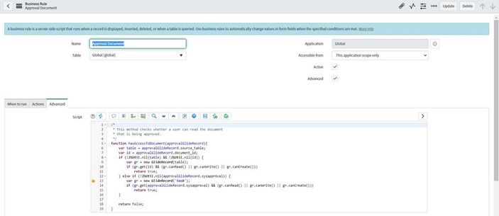

When we upgraded to the Vancouver version, the approvers can see records that don't belong to them.
I found an ACL in sysapproval_approver table. And I think it's the hasAccessToDocument in the acl that's causing the problem.
Does anyone know how hasAccessToDocument works?
If we just want approvers to see their own records, can we disable hasAccessToDocument and Does disable hasAccessToDocument have an impact on other features?

If the document is found (gr.get(id) is true), it then checks if the current user has read, write, or create permissions on this document (gr.canRead() || gr.canWrite() || gr.canCreate()).
Then they can proceed with the approval.

Hi @menghui,
This function is present in a Business Rule on the global table, it checks if the user can read the document that is being approved.

if (gr.get(id) && (gr.canRead() || gr.canWrite() || gr.canCreate()))​
Actually, I don't understand this code.
Does that mean that if approver can see documents that are approving, then he can see that approval records?
