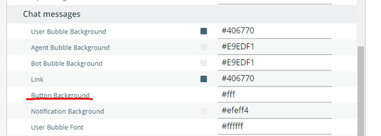

I must be missing something simple. I am trying to change the color of the font on the button.
The button background can be changed easily using the button background attribute below
How do I change the color of the font? I have modified all the fonts in the branding and nothing has changed it.

I'm dealing with the same issue. Since the Vancouver release the button color and font has changed, so I want to change it back to the original settings.
Have you been able to find out where this can be changed?

Did you find out where to change the font and color of the buttons?
Due to the Vancouver update the font and color are changed for the buttons and I want to change it back, but don't know where. Indeed via the normal Branding page, this cannot be done.

This can be changed in "sys_cs_branding_setup" table for column "Button Selection Text" in the list view for the record. By Default "Default Branding" is the record but if you are using other/custom branding, select the respective record to update the "Button Selection Text".
Please accept this answer if this works for you. @Nicole Botty @kwong43
